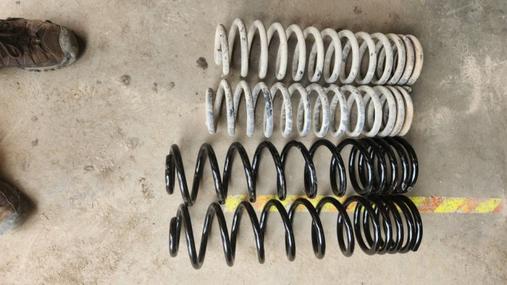

If you want more rear lift its easy, EVO Jeep Gladiator 6.5" springs and Bill 5165 resis for the rear.
This is what the EVOs look like besides my old Superlift springs.

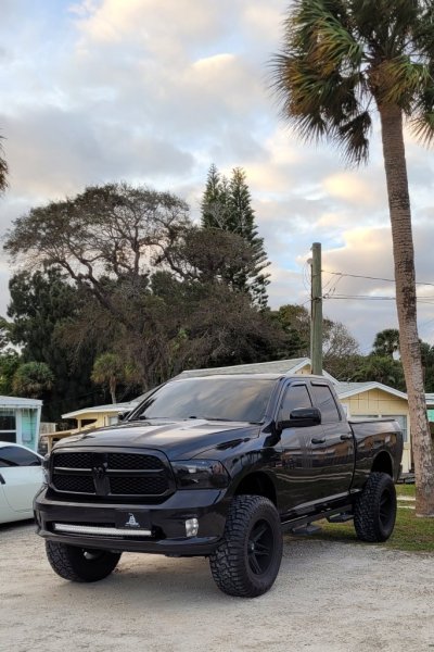

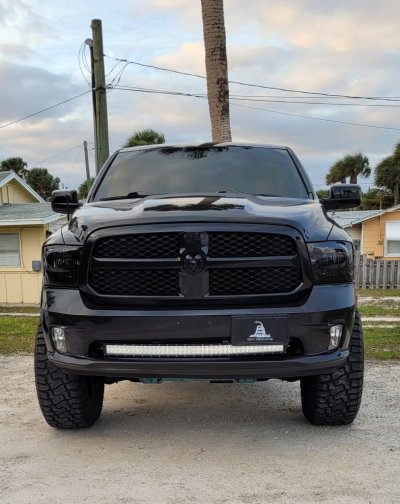

You don’t want a level ram because the hood is higher than the bed even with a tonneau cover. RC has a natural nose high look because their lift geometry is terrible. Unfortunately saving a few dollars usually costs more than a few dollars to drop a new front Diff and cv’s into it. That said what’s done is done but do not stretch that lift any higher. Post a few pictures of your truck and we’ll get you dialed in. Don’t just throw parts at it trying to get where you want to go.
Start with pictures

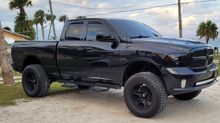

Sorry, I think it doubled up the same 3 pictures. I need to measure off the center of the wheel but right now I believe I'm about a 1/2" lower in the front. As you can see at full compression, I definitely rub a little up front. I really don't want to go up more than 2" but I appreciate your input and want to do it properly. The front RC N3 struts are a 6" lifted struts with no spacers.

The stance looks good to me. I wouldnt want the front any higher without raising the back too, personally.
I dont think you want to stretch that kit out much. I would leave it and do any trimming that was needed.

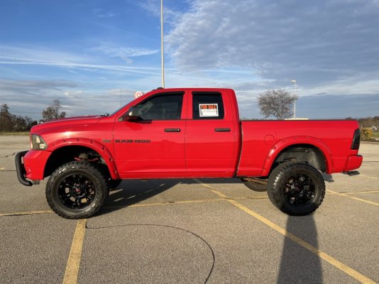

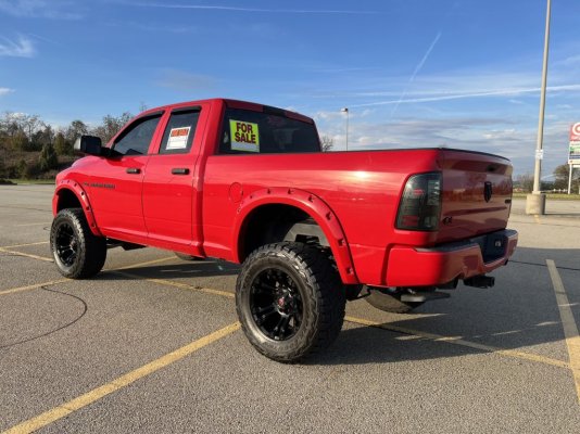

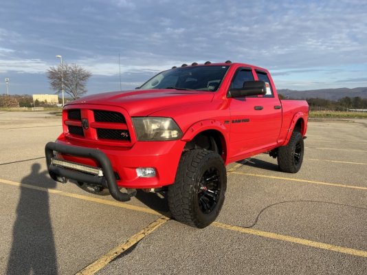

This was my old 2012 Ram 1500. I had a 6" Zone suspension lift and the Zone 1.5" body lift. Bilsteins on the front set at 2.1. I had 20x10 Fuel wheels wrapper with 37x13.50x20 Toyo R/T's. Pictures for reference.
Hindsight, it sure looked great but man, it just became too much for me. But, that's just me.
