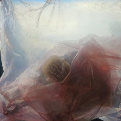

Hey @Burla I need some help! Could you take a look at my pictures and let me know what u think? I followed your advice blindly, i got the white connector solenoid pack. But now that i installed everything and it wont start, i'm thinkin its the wrong one? My connector from the truck looks grey, the old one looks yellowish, and the new one looks white. Should i take it back and *** grey?
Anyone with more info please help me
In the picture you see on bottom left, the new solenoid pack connector, installed. The old part I took off, in the middle. And the harness connector which clearly is grey.
My truck wont start because it says im in 1st gear, and mines automatic trans. Shifter feels way loose and disconnected.
@here
@here
white solenoid universal...
with early 4 gens grey has been a fitament issue in many of them, the usual sypmtom is being left in limp mode cant go past 4th gear, why most trans shops generally use white as reported.

So most likely your linkage in the trans is not matching the position of your solenoid. Your linkage is probably in park? But your sensor plate is in first. If you spend anytime in the linkage pm me there is a glaring weakness that also should be fixed.
It looks like 2012 was the first year you need a trs plate, but you can research it yourself grey solenoids issues are many fold, especially with aftermaket valve bodies that were built with wrong check balls, happened so many times here I lost count.

Hey @Burla @Ludville1 Good News!
My truck just started!! I am going to idle and get the fluid level just right before test drive.
So, what happened was it was the wrong solenoid for me. My old one had a white connector, so I figured that was the way to go. After taking a closer look, I learned that the white ones have 25 terminals on the connector, and the grey ones have 23.
So I counted the terminals on my old one and behold, it had 23! So.... wowww.... connector was white, but supposed to be grey, go figure. So I exchanged it, big price diff
.. this one was $515
But that should fix all my issues! I hope. So far so good, she fired up well and sounds good so far.
Thanks guys for the help!
