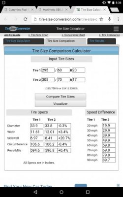

I would like to upgrade my wheels to a 20"
Still debating on looking for some OEM Laramie wheels or going aftermarket.
I'd like to level out my truck and put some 35" tires but since I tow, I don't know how I feel about needing airbags to level out my truck after its loaded and loosing some gear ratio going with a tire that's 2" taller.
Would 295/60R20 Nitto Terra Grappler or Toyo AT fit on my truck with the OEM Laramie 20" wheels without being level? Or an aftermarket wheel with a similar sized tire, what offset should I be looking at?
Any suggestions and help pointing me in the right direction would be appreciated
Power247
Jul 26, 2012
5,615
947
High Point, NC
6.4 HEMI
You should be able to fit those on factory 20s without any issue. I have 305/70/17s (same height and a 1\2 inch narrower) and they barely rub the passenger control arm at full lock and full articulation.
