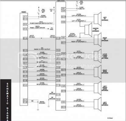

are the main front speakers plug in and play? or would i need to wire them up if i replaced them?

You will need to at least spice. The factory speakers have a harness whereas aftermarket uses the spade type connections, one fat one thin for each. I have a pic of a wire diagram somewhere if you want me to post it

yeah can you post that when you get a chance? I'm just thinking of whether or not it's best to buy new speakers while the truck is already apart when we're installing everything..

the door panels are not hard to get off at all. 4 phillips screws and 1 10mm bolt holding the door handle you will need a socket with a 3-4 inch extension to get. the3rd gen ram doors are by far the easiest door panels i have ever removed.
here it is for the infinity system. wire colors should be the same let me know if it doesnt mesh ill find the other wiring diagram
