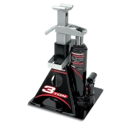

Here, 30 bucks at tractor supply.

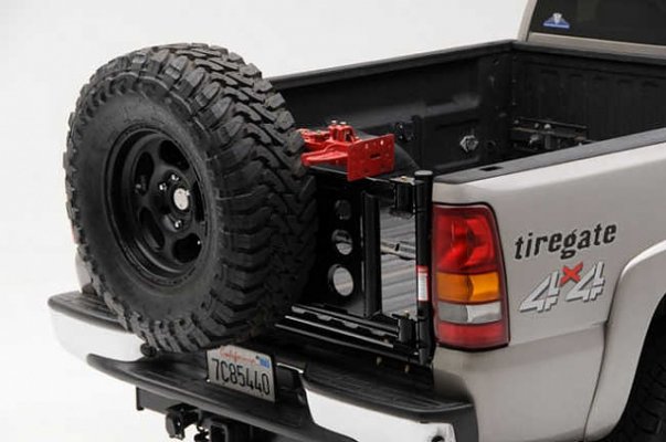

Something like this if you don't want to carry it in the bed.
Looks like this is a hitch mount re-locator. Might have to relocate lisc plate.
I'm with you though, these tires are F'n heavy, even stock. The other thing you could do it get a lighter 1/2 spare that would just get you to a shop as opposed to having a regular tire down there.
