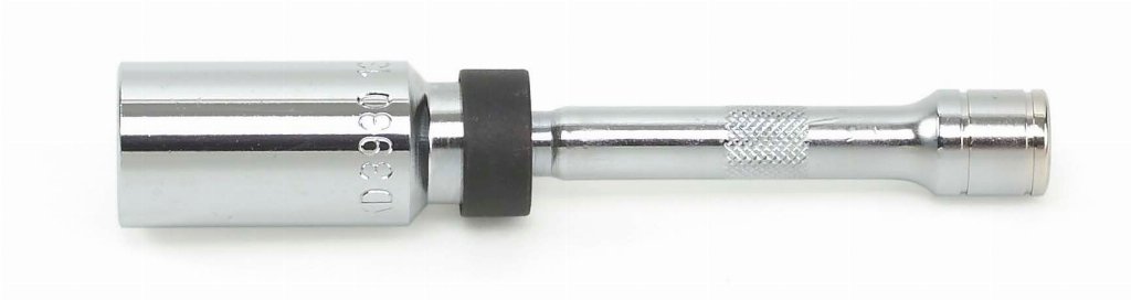

Thanks to this write up and helpful info from Matt from Moe's. I will be knocking this infamous Hemi 16 plug change out this week. Bought the anti-seize just in case, its only $3. Another thing I got was the Gear Wrench 5/8" x 6" Magnetic Swivel Spark Plug Socket from Advance Auto. The extention is permanent, so I wont run into the problem of the socket getting stuck in the head. And instead of the death grip rubber boot its magnetic.

There are many times you have to put the socket then the extensions in one by one so I am not sure if you will like that setup honestly.
$miley
Big Boi
Aug 31, 2011
2,314
180
S. Fla
2009
$miley
Thanks for the heads up

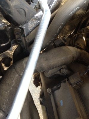

Hey guys. Great write up and info!
Question - the passenger side cylinder bank, very last cylinder closest to the firewall - it sure looks like those 2 heater hoses will be impossible to clear!! Ah! They sit about an inch or so above the coil pack. And they are held there by a funny looking bracket that doesn't look removable.
Did no one have trouble w this?!
Also there is a 1.5" diam harness over this coil pack too. Wtf?
I have an 07 quad cab 1500 hemi. 45K.
Thanks guys.

Maybe a picture would help understand what is in the way. My truck has been changed over the years I don't remember what was originally in that area that would be a problem.
Thundergun
Mar 31, 2014
17
Hello - Here are a few images. the image with the wrench in it is from the original post. doesnt' look like he had to move the 2 heater hoses (i assume thats what they are), but the clearance looks pretty tight, especially considering the boots are ~4" long - how did he clear it?
and i don't see the 1.5" harness in his way.
hopefully you can see from my pics what is going on.
Thanks!
