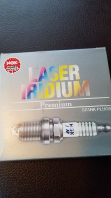

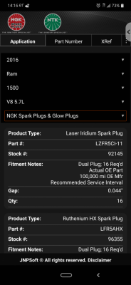

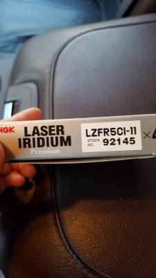

These are what you want. They are OEM plugs. NGK Laser Iridium
Some have used other brands with mixed results. Some trucks do fine some don't. With 16 plugs to change every 100k miles, do it right the first time and be done with it. If your truck doesn't like the other plugs your out that money and time.
But it's your money and time to waste.
