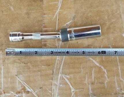

Sorry, I don't understand the problem. I change mine without issue in an hour or so using a single socket I bought at the local auto parts store. It has a swivel built into it and a magnet to hold the plug. It fits all 16 plugs. I have a thick towel thrown over the radiator and use a box I built for standing or sitting on while working on different stuff.

Well, this was my first time since I got the truck. And I had a small issue of one of the sockets getting stuck down in the hole as the plug went past the rubber part and I couldn't attach the extension to it. Took forever to get out and ended up using one of those super magnets to pull it out. Your tool you have would have been awesome to have, RedTruck-VA. Either way, I'm sure the next time will end up being fast. First time is always fun.
