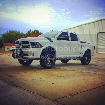

I am running the maxtrac 4.5" spindle with the 3" coil in the back. This is what it sits like on 35x12.5's. I went with the 3" coil over the 1.5" spacer to keep some rake for towing. It's a lot better than my 09 2wd CC I had with spacers.

Thank you! Yea i just needed someone with that setup to see for myself. I'm going to go with the spindle and coil lift!
Your truck may not sit identical to mine. My truck only had a 1.5" rake in the front from the factory. The 4.5" / 3" lifted and leveled my truck a complete 3". So if your truck only has a 1.5" factory rake, then your truck will look just like mine :)

What's the best way to tell how much rake you have from the factory? I'm trying to figure out if I need to go with 1.5 or 3 inch in the back with the spindles.
RyanJM
Apr 24, 2013
644
208
Houston
2014 Express RC Black Edition
Measure the truck on flat ground. I measured to the middle of the wheel well front and rear. That's how I chose mine.
