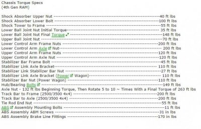

I put all the control arm bolts to 150lbs, not sure what they are supposed to be but that was the torq I found for a 5/8" bolt.
I probably should have read the instructions...
This might help. :favorites13:
R/T_Fire
R/T_Fire
Feb 3, 2015
3,432
1,207
Pleasant Grove
@davidram are the control arm or link bolts to chassi grade 5 or grade 8?
or did I read it wrong that they are 110lbs?
DavidRam
Feb 19, 2014
9,094
3,921
SoCal - Redondo Beach
2012 RCSB
It's 200 on both ends of the lowers, and 120 on both ends of the uppers.
I don't remember the factory bolts, but I did replace mine with grade 8 when I did my Spohn adj arms a few years ago... I always like to use new/upgraded hardware when installing new parts.
Just check the lines on the bolt head and see what grade they are (3 lines for 5, 6 lines for 8)
