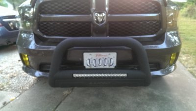

Ok, here is the one I used.
Lund 27121204 Black Bull Bar with Integrated LED Light Bar:
http://www.amazon.com/gp/product/B00WA4BGS4?psc=1&redirect=true&ref_=oh_aui_detailpage_o00_s01
Added bonus with this bar, it can retain the OEM tow hooks if you have added them to your express or sport AND you don't have to relocate the front license plate if your state requires one.
I am ordering a 19" x 1" custom yellow film tint from Lamin-X to match the light bar to my fog lights. I haven't wired in the light yet as I am trying to find the best way to wire them in with the high beams, but also have a cut off switch in case I don't want the light bar on.
Install takes some time, I would say the hardest part is removing and re-installing the lower black plastic splash guard after you have cut the 1" x 8" holes in it to accomodate the mouting brackets (instruction say 1" x 4" but the longer hole gives you better clearance to reinstall). Cutting is pretty easy and its on the bottom of the truck so if you mess up it is not something you have to look at daily.
One other modification to the Lund install instructions, the rear tow hook brace says to install it to the inside of the bracket, but with the tow hooks installed it will interfere with the bull bar bracket itself as both will be sharing a lower hole. I moved this bracket to the outside and the bull bar bracket to the inside and all fit well.
I was running out of day light so if you want more pictures of the install I can take them tomorrow, but it's pretty straight forward.

That thing looks beefy, dang.
Does it have spots to mount more lighting on top?

I'm really satisfied with it so far. The fit and finish exceeded my expectations. The finish on it is line-x "like"...

Sorry, didn't answer your question...no, there are no pre-drilled locations to mount a light bar on top. I'm not sure if it would work well as the shape of the bar is more oval than round. For me, this was ideal to have the light bar integrated as Illinois requires an unobstructed front license plate.

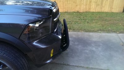

Here is the side shot...
It needs to be adjusted outward some but it will do for now (notice the oval shape).
My phone camera is crap so I used the video from my dashcam DVR and uploaded it to YouTube here (watch in 1080P you really only need to see the first 1:10 seconds)...
https://youtu.be/cAVvvZ_leVA
let me know if you want specific pictures and I'll get them.
