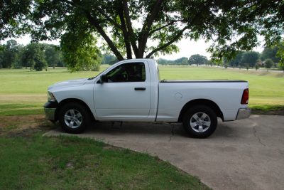

Texjim, got any pics, would love to see how it turned out on your ride

I wil post some pics tomorrow in the daylight. I cut one coil as instructed and it rides good. It is about 2 inches lower than stock and rides better. The bilsteins helped a lot as well.
