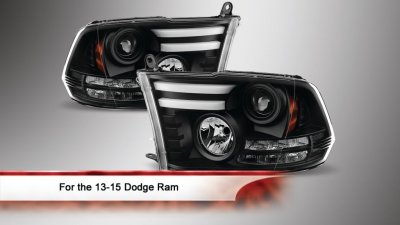

just curious if anyone has these headlights and if they baked them open to mod them out yet.... like changing the leds in the 2 white solid bars etc...painted the lower chrome...or even just baked them open...i got condensation in one and figured id want to do some custom work to them since i got hem cracked open lol....i checked online and couldn't really find anything tbh.

Theres a member on here, i think its PRDATOR or something like that, i think it was him, but the member opened those lights and retrofitted Morimoto H1 Projectors and he installed new led boards behind the white drl bars. He said he used the Diode Dynamics Mustang LED Boards for the newer mustang headlights as they fit the design and space.
If you search the forums for retrofit or aftermarket retrofit, maybe even ebay retrofit im sure you can find the thread. i think its about a year old now.
