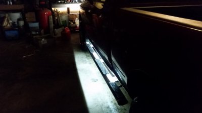

Blackbetty14 do you have a close up of where you exactly installed your lights to shine on the nerf bars more than the ground.

Not at the moment... only nightime photos.
It's the vertical peice below the door on the rocker. I didn't put it on the bottom of the rocker right below the door due to the factory drainage holes. I can try to snap a pic tmrw but we're getting snow.

Ok sounds good, i am planning on playing around with it a little anyways to see how i like it the best. Did you just use the 3m tape to attach it or did you use anything else. Just not sure how the 3M tape will hold up or how long it will stay on there. Dont really want it to fall off going down the road.

I just used the 3M tape. The key is a clean smooth surface for it to adhere to. I've had the stuff stick for a good time. Key is warm temps (I use a heat gun I'm the winter and make sure the surface us perfectly clean and oil/wax free. I had been using meguires can bra car wash with wax in it, then all the road crap and salt from all the snow. I cleaned it off with windex first then used brake clean to get all the wax and oils off. Used a heat gun as I applied the LEDS and then once again after I stuck it down making sure it was down and warm. I will repress it in the warmer months... but should be fine.

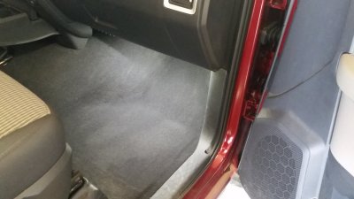

Looks good! I guess u stuck them where I had put Mine and It lights up the side steps nicely. How many LEDS did u put in the footwells?

I have a strip about 12" long on drivers side and 17" on passenger side.
