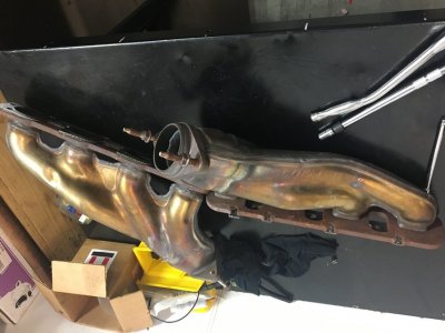

2012ramHEMI
Feb 27, 2014
57
Houma, LA
5.7L HEMI
Did you ever get these installed?
Ive got a set off a 392 challenger im planning on installing in the next few weeks, ill also be dynoing it before and after.
