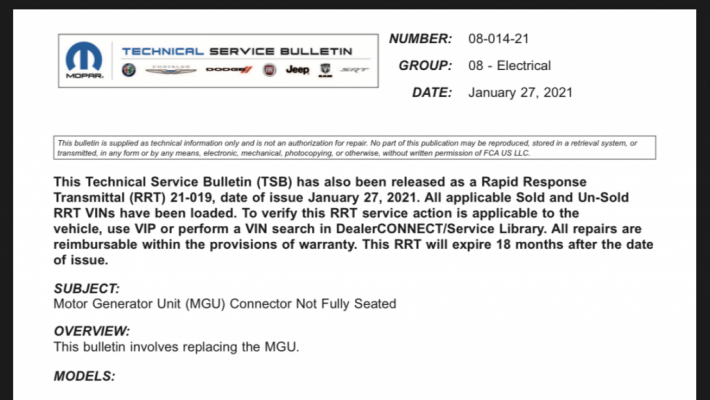

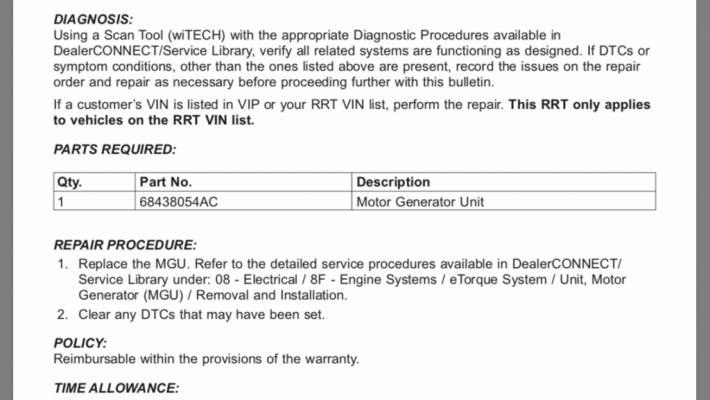

~100 cases reported on another forum. It’s an eTorque problem.
Issue now is 2022’s are still reporting stalling, but the TSB doesn’t cover them.
