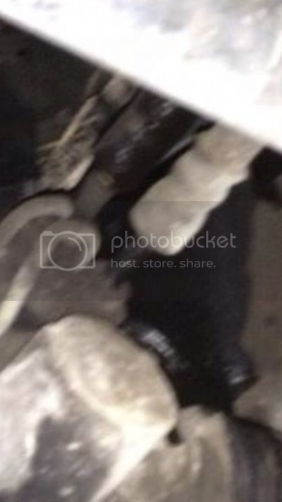

Pics

Looks like it's coming from above in that pic.

No stabilizer, fluid looks mostly clear...not my doing. I did however add some of the same to check if it made a difference, really dark new areas are from spillage I think. It almost looks like the leak originates where the steering shaft comes in.

Do you have any power steering right now? It almost looks like a seal on the rack blew... Is the boot inflated?

I think that was from spillage. I have never had loss of power steering.

It did look like that hose should be further on, I pushed on it but it wasn't notable loose

What is that hose running to? You shouldn't be able to just push any hose on ever. Haha. That's not a good sign. Got a closer picture of it?

Thats the line going to the cooler. It should have a clamp on it, those do fail easily so that could be it
