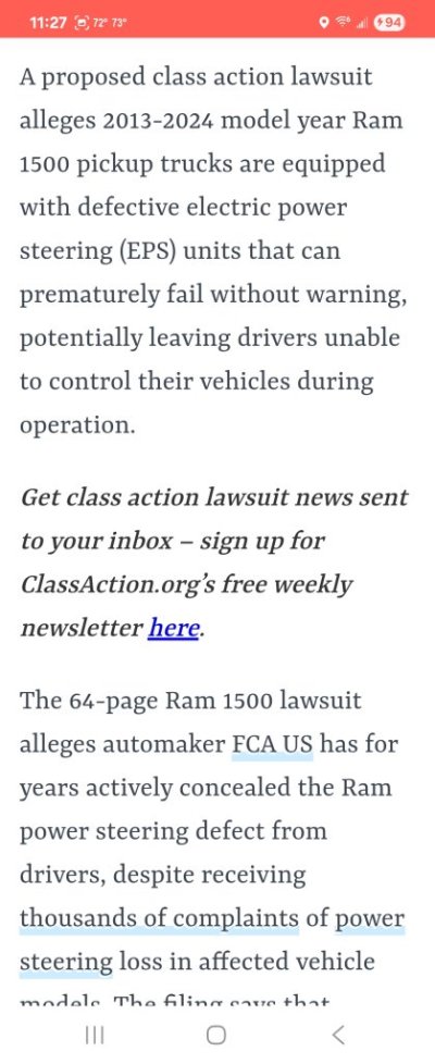

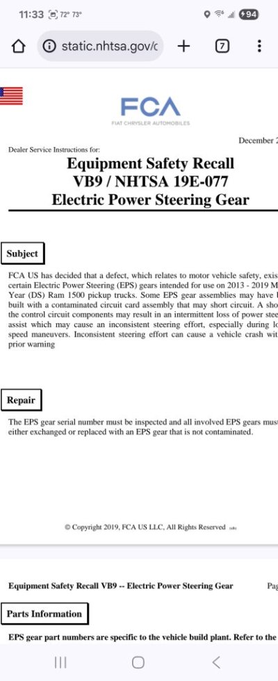

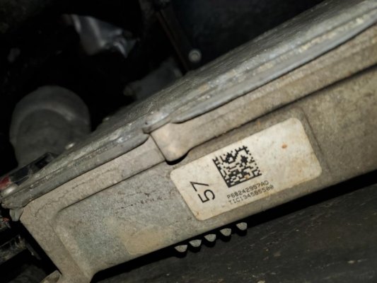

I have a 2015 RAM 1500 with about 164500 miles. What I've noticed driving recently is when merging into the right lane or following a right curve on the interstate, the steering wheel will turn a very small bit, like possibly 10 degrees. After that 10 degrees is a bunch of resistance, and when I overcome the resistance, the steering wheel jerks like 25 degrees. The jerk in the steering is only really noticeable at higher speeds, mostly above 40 mph. It is not noticeable when making a proper right turn, such as turning onto a street.
