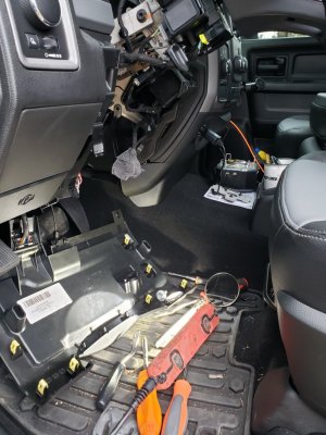

I installed these on my 18 ram 2500 and yes it was time consuming. about 1 1/2 and I used a flat head and a mirror to remove the air bag hooks/clamps. They automatically worked.
The photos make it look messier than it really is. I made a little mark on the threads where the steering wheel mounts just to reduce error.

thanks for the pictures, it is good to see another person's work. it will definitely make it easier. just wondering, what did you mark I'm not sure I'm seeing it on your photo. but I'm also concerned, is there a software or some type of code flash that the dealership needs to do to allow those new buttons to work or do they just automatically work because they are now plugged into the wiring? thank you again really appreciate it.
