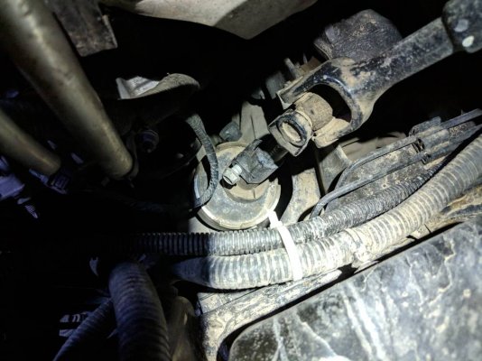

So I just had my truck in for broken exhaust manifold bolts on the driver's side. I got back home and noticed some steering wheel slop that I'd never noticed before. There seems to be some take-up before it "grabs" if that makes sense. Along with that there's an annoying squeak in the slop area.
My question is, could they have adjusted something or disconnected the steering while they were in there that could be causing this? Maybe something didn't get tightened all the way? I would love any feedback or experience you have with this.
If the slop is normal, any ideas where that squeak could be coming from?

It's not normal. They surely disconnect your steering shaft to remove the manifold but they mess up with it while reconnect it.

Any idea how to fix it?
*Edit - After some more searching I came across this video and sure enough there was a bolt on the steering shaft that was super loose. It was barely even in...(you can see how far that bolt is sticking out)
Tightened it up and the problem is gone.

Haha yes it was, I guess I didn't specify in my original post but yes it was at my local dealer and they fixed the manifold bolts under warranty, and didn't hook the steering shaft back up correctly.
And no, I won't be taking it back to them for this, too much hassle, plus I already fixed it.
