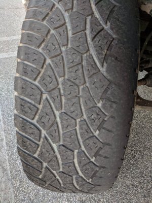

Here is a picture of my driver front tire for reference.

I figure i need to resolve the source of the problem before i get the tires looked at/replaced.
There could be an issue with the tire, that is causing the issue. My steering wheel was shaking and it ended up being a tire that was separating internally.
