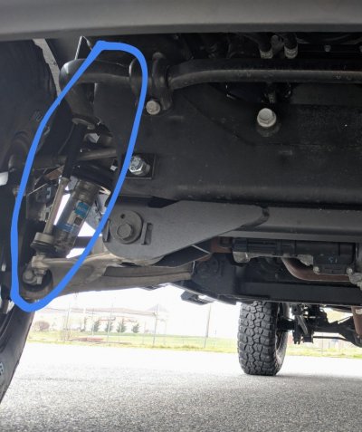

OP check your end links to make sure they are all tight and good to go. Yours may look slightly different since it's a 2019 and this picture is from my 2017 but it should look relatively similarcddb21932a22a7383c41977e9ed0ba35.jpg
