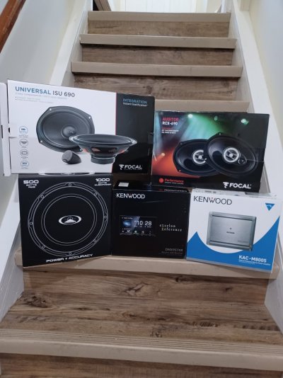

This is what I had installed recently in my 19' Classic with the 6 speaker system, and what a huge improvement.
I second Focal speakers. The detail and clarity with these speakers is phenomenal, and they handle power very well without compromising integrity or sound quality.
* Edit - replace those dash speakers. The Focal kit I used has the front door and dash 2-way set speakers. Then replaced the rear door speakers with the 3-way set.
I had a marine grade Kenwood 5-channel amp installed on an elevated platform under the drivers seat, and a top line Audiomobile 10" sub in a sealed custom box that was stuffed with insulation to better the sound. All this attached to a new Kenwood head unit, and now it's the perfect system, for me.
I was also done dealing with the continual UConnect stock deck issues, so I knew it was time for a quality head unit and be done with issues. I just took it a little further and said screw it, time for a whole new upgraded system.
I am a music lover and am in my truck a lot for my career. So for great music quality, it was an easy upgrade.

I like that you went with components for the front. Enjoy!
Thank you!
IMO - one needs the dash speakers to compliment and balance the sound. Plus with the head unit, one can set the seating position on this Kenwood so the system provides the best balance of sound in the cabin. I have the seating position set to driver.
Adjusting the various settings for crossover's etc., will ensure that the brightness of the upgraded dash speakers doesn't overpower the sound quality and hurt ones ears. Only having door speakers and now dash speakers brings the sound down and IMO doesn't afford the listener to enjoy the real details in the music.
I hear in music now things I've missed for years, for instance, with Peter Frampton "Do You Feel Like We Do", or Chris Stapleton (all his songs), the instruments, clarity in guitar, etc.
However, it's all really to do with what the listener wants to achieve. I wanted ultra clear and detailed sound quality and went with Focal because that's what they are know for delivering.
I also went with a single high quality 10" sub from Audiomobile because they are know for delivering exceptional bass response in a purpose designed slim sub for sealed boxes in very small spaces. Then the right amp to power it all the right way without overkilling anything.
