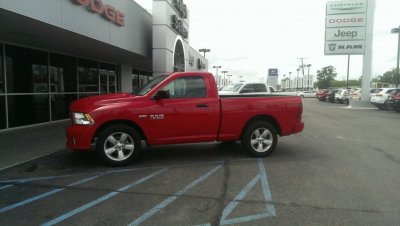

Hey Guys! Bought my 2013 reg cab two weeks ago. Last weekend did tint, subwoofer install, debadged doors. Last night I ordered the Diablo Intune with Hemi fever tuning. I am going to use the 93 octane when it arrives. Two questions, what are the power increases on the truck now, stock? What should I expect with the Hemi fever as far as an increase over the Diablo 93 tune? Prolly installing a 180 thermostat today if Autozone has it in stock. Vararam, trip to local exhaust shop coming up shortly. I ordered my build sheet from Chrysler, I am stuck with 3.55 gears for now. Will Motive 4.10's or 4.30 fit my differential housing? Did a powerbrake burnout last weekend, looks like I have an open diff. That's another expensive issue I am looking to fix. O.K., that was more than two questions! Thanks Guys!

First off nice truck and second your truck will feel night and day difference with the HF tune. Heck mine felt night and day just from the canned tunes. I believe you will have to machine the carrier to get the motives to fit. So far people have done factory 4.10s and factory LSD with no problems. Good luck with your build, you will never want to drive a stock one after that.
