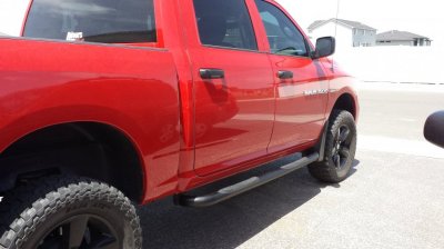

I have stock rims with 35x12.5R20s on them. The 1/4 wheel spacer is only needed in the front.
