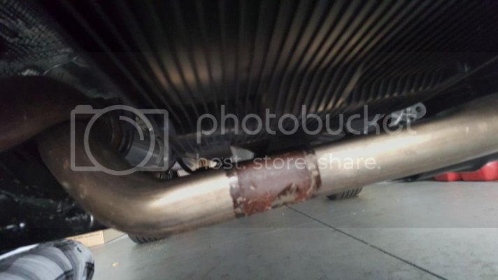

Wondering what the stock pipe size is on the y pipe that goes under the 8-speed. I was thinking about wrapping the pipe under the 8-speed to reduce the heat directly under the plastic pan. I know it is kinda flattened on top but I was gonna try to rap it from the round part before and after the pan. So what size? Also any thoughts on weather this is a good Idea or not. I already have the Lava Wrap so why not give it a go.

So I climbed under and measured it. 2.5" diameter. I will have the clamps tomorrow. Once installed I will report back if it makes any difference in tranny temps.

Before wrap.

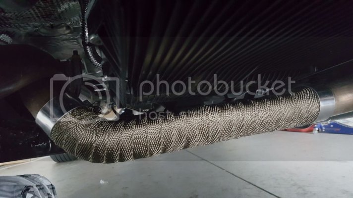

After wrap.
Will report back on temps soon.

So from the limited in town driving I have done so far it has dropped the temps by around 10-12deg.
