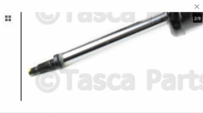

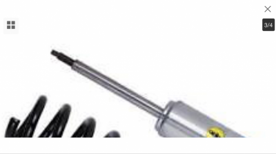

The stock struts shaft is machined down on the end and threaded. This makes it have a step to prevent it from going thru the mounting hole. The Bilstein 5100 isn’t exactly the same dia so they give you a washer that goes on top of the stud before you reassemble and put the top on. Some people don’t put the washer on first, they put it on after the top but below the but incorrectly and then this will allow it to breech that hole in the frame mount. His doesn’t “appear” to have had the washer at all.

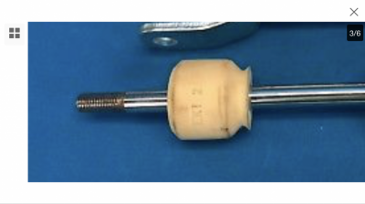

The Bilstein 6112 doesn’t use this washer because the shaft is a much larger dia and machined down like stock to provide that step so it’s not an issue with those. The body itself is 2.75” dia.
Pic Comparison:
STOCK STRUT
Bilstein 5100
Bilstein 6112
