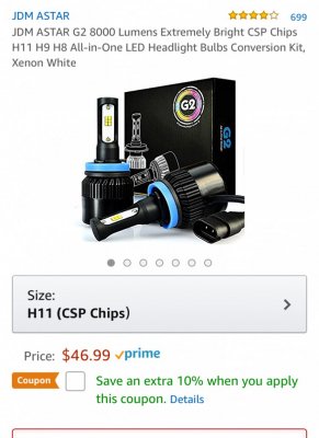

I had these in our Journey headlights and fog lights and have them in our Charger right now and they are great.
I will get some for my Express soon.
Got them from Amazon.

Oh and they were plug and play for both vehicles. I did turn the aiming down just a little on both also. Beam pattern seemed to be the same as the stock bulbs when I compared while putting them in. I have not been flashed with them yet.

Thanks for helping me out, have you confirmed they work in a 2018? Can you explain turn the aiming down? Noticed you were from Pa, what part you from?

No. I haven’t confirmed they will work in an 18. Both vehicles I had/have them in are 12s. On both vehicles I replaced one bulb and then shined the lights in a wall for comparison. The replacement bulbs light pattern looked to be about the same, but I wanted to aim them down just a little to avoid blinding incoming traffic shiner they don’t have the cutoff a HID setup would. Anyway. Found the adjustment screws and turned them to the left a few turns. Replaced the other side and then turned that one down to match. I probably didn’t need to do this, but they still light up the road nice and like I said before, I’ve never been flashed.
