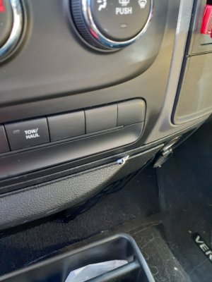

These 2 areas on my truck are EMPTY!!
I would like to know what's possible if anyone has the knowledge.
First is the upper center console area:
What kind of room is behind this area??? is that metal housing up there???
CAN I ADD ANOTHER CABIN LIGHT THERE???

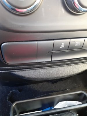

The second area in question:
is there USB chargers, switches or anything that FITS exactly in any of those removable slots??? Everyone knows they are easy to remove, but buying something that FITS there... is that even possible... where is a source for me to browse even???
THNX guys
Shawn1986
Mar 13, 2019
37
23
DFW
The bottom area is where the heated and vented seat controls would be on the higher trim packages.

4th gen electronics can sell you upfitter switches. Its something at least: https://www.4thgenramelectronics.com/
These additional aux. switches are also fully controlled by alfaOBD once installed... a switch can be one without key in, it can also be a momentary switch for a horn or whatever... this thing is well worth the money!!!!
THNX again for the link.

The backside of my switch panel was solid, meaning I have no way to remove the switch faces and drilling through appears to not be an option either, I am sure there is a near full length PCB inside of there.
This may not be the case with a truck that only has 4 or 5 of those switches in place but my trucks panel has every one of those filled save for the diesel exhaust brake location that is not on my Hemi.
