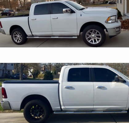

I went Bilsteins set at 2.1 but stayed with an oem sized just more aggressive tire.e8c98df6d71e402bc6df16bb2fdfe1d6.jpg

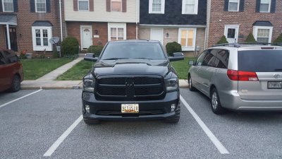

Bilsteins on the front
Factory wheels
33x12.5 nitto mg
No spacers
mwright813
Apr 11, 2017
18
8
You cant tell in the front pic but the tires definitely stick out past the fenders

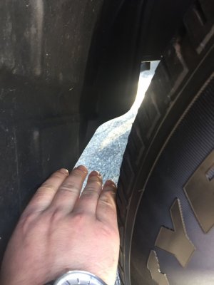

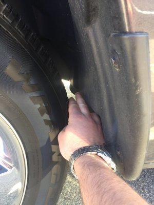

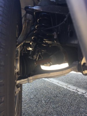

Hopefully these pictures will show the room I have with the stock tire and the level kit and give you guys a better idea:
