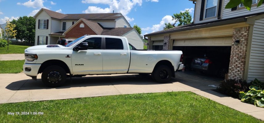

2023 RAM 3500 6.7L H.O. AISEN LARAMIE 4X4 CC DUALLY LB looking to go wider tires. On dealer stock Nexen junk tires, time for new. Want to install wider tires without using spacers on the rears & no lift/level kit installed. Have heard 245/80/17's also heard 255/80/17's will clear without rub. Can anyone please advise which is accurate??? Thanks Rhumphers9a.

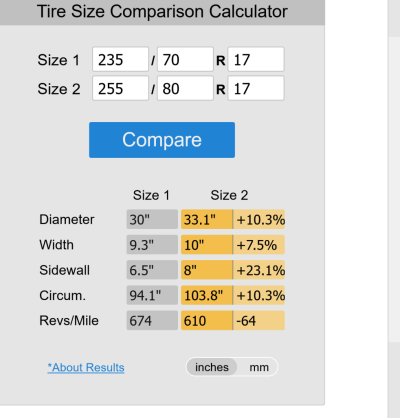

IF you own a measuring tape it is pretty easy to know what will work and what won't. How much space to you have now between the duals. One inch is 25.4 MM so 255 is 10" wide, 275 is 10.8" wide. A one inch wider tire adds 1/2" to each side of the rim. There is a limit to how wide a tire you can mount on a stock 6.5" rim.
Plug your tire choices into this. It will give you lots of useful info.
