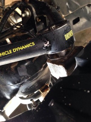

ImageUploadedByTapatalk1395708098.636424.jpgImageUploadedByTapatalk1395708106.235591.jpg
Anyone know what this spring might be coming from under my a arm ? Just noticed it today
bloombloom88
May 31, 2012
1,961
145
Plano, Texas
2009
4.7
Are you talking about the retaining ring that's hanging down on your upper ball joint?
yodge
Jul 29, 2013
852
180
Huntington Beach CA
2013 ram 1500 hemi
Yes I called icon and apparently I can put it back in myself
