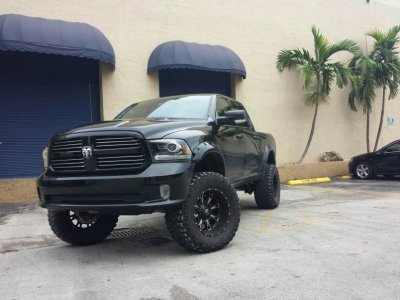

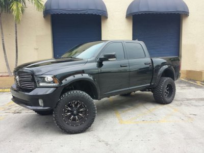

just noticed i forgot to answer this!

really late! but i just added pics lol

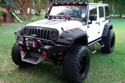

You sir... Must have $$$
i always think my buddies Jeep is a lot more... exaggerated than my truck... LOL
I guess its alright to post pictures of it, its all in the Chrysler fam
