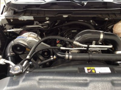

Yes. Difficult to see but the idler pulley is just above the water pump pulley (left of stock pulley).
Tach_tech
Jun 1, 2014
3,320
3,595
5.7L HEMI
That’s a decent amount of wrap around the supercharger pulley. Pretty similar to the whipple setup. I know when I was putting the belt on mine it was a fight cause it was so tight.

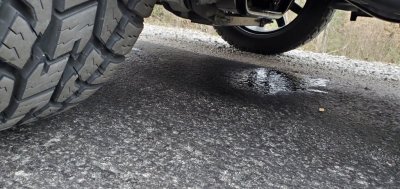

Little update. Had a wedding to attend little over a week ago down in Mississippi and against my inner voice telling me not to take the truck I did anyways. On my way home just cruising on the highway I blew 2 fuel injector orings, and fuel leaked all over the freaking place. Luckily I do not have cats so fuel didn't ignite. Towed off highway and rented car to get me home as the local place could not fix (nor would I want them to). Truck is still down in Tennessee waiting for a carrier to ship it back to my tuner to fix the issue. **** happens.
First inspection tells us the tabs on the fuel rail were welded on incorrectly and not perpendicular to the injector center-line causing the orings to eventually blow out. Hope this doesn't' come to a finger pointing issue.
