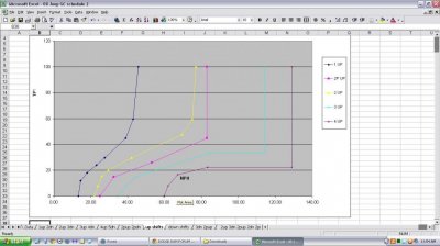

Was hoping I could get some input on my schedule for our 08 Jeep GC...it's much better than stock, but just like stock, I can't get it to stop skipping 3rd gear in most situations. Holds first and second just like I want, then goes straight to fourth and holds that just like I want until fifth but in normal acceleration it skips third.
I've got an 02 Dakota running a Jeep TCM (to allow 5th gear) and it clearly uses 3rd gear. I'm very familiar with the transmission but stumped as to why the Jeep does this.
If I force 3rd gear with the auto stick it does just fine and provides a nice slight RPM drop.
My graphs look good to me and the shifts are good though I've only been able to drive and adjust a few times.
Thanks! Sure wish some of the people on JeepForum knew anything about anything...all they seem to know is how to plastidip and put on a 'sweet' budget lift.

Graph looks ok. Can you post up all your throttle percentages, so we can see where you have your shifts set?
Never done a Jeep, so maybe Scott and I can collaborate on this one. :)

I can do screen shots again when I get home, but I'm more than happy to email you the excel file if you want to put it in that database.

Data screenshots for anyone interested...
The mph numbers are rounded off because I did a cursory tune in the Jeep, then adjusted with the tables on the PC and picked the closest number once back in the Jeep.

New schedule for your Jeep sent. Thanks to Scott! Let us know how it goes. :)
