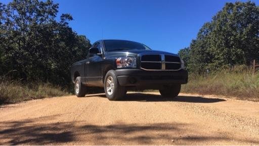

This was before. The chrome bumper had been “paint matched” poorly and had a lot of rust spots forming. I put plasti-dip over it but it didn’t stay for very long. Before I put the bumper cover on I made sure to remove the plastidip and covered the rust spots with something more permanent

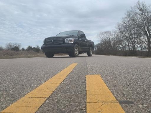

And here’s after I got everything on the front end paint-matched. Definitely not my best pic, I’ll go out and get a closer view here in a little bit
