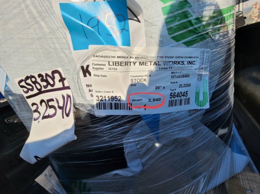

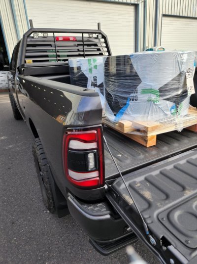

2500s diesel 4door long bed max payload has always been below 2600lbs since 3rd gens, i don't know 2nd gens stats 3500 is a lot more. The new 2022 3500 actually ride just as nice as the 2500s from what i hear. The difference between a in bed camper and towing a trailer is two different things you cant even compare the two...

I had 5800lbs in the bed of my 3500 the other day and you had to drive slower around corners lol. Even a 3500 over payload doesn't preform well.
