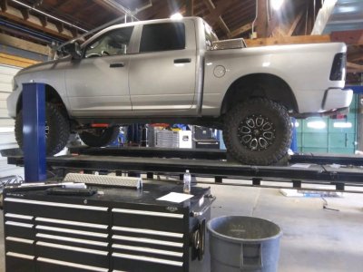

I started with a RC 6” lift with their 6” leveling struts. I’ve got a 2016 Ram 1500 4x4 Crewcab Tradesman model. I also had the same questions about week points and started researching weak points and better options. I went with RC bc honestly I was on a budget. It’s a good kit but doesn’t (imo) cover all what I needed. I had bad wheel hop in the rear and it bad angles in the front with my UCAs. Not all lift kits are going to have issues depending on each person’s opinion. It just all depends on what you want and are going to do with the truck. I’ve pretty much upgraded everything in the RC kit with the exception of the crossmembers. I wanted beefier more heavy duty parts for what I knew I’d be doing with my truck. I’ve upgraded struts to bilsteins and yes you can tell a difference in ride quality. IMO, i feel RC should upgrade their rear sway bar end links and provide a rear control arm relocation brackets like Procomp does. But in the end it is your preference. If you do regular maintenance and pay attention to your suspension a RC lift will treat you right. If you have any specific questions about the RC lift just message me. I regularly have sat down and just ask a **** ton of questions to them and have gotten a-lot of good measurements on their parts and why they make them the way they do.
