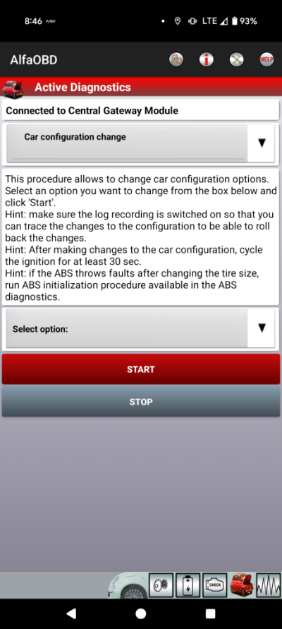

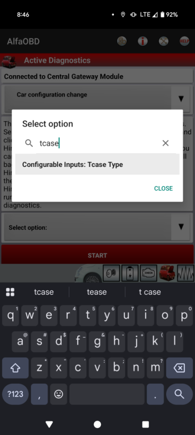

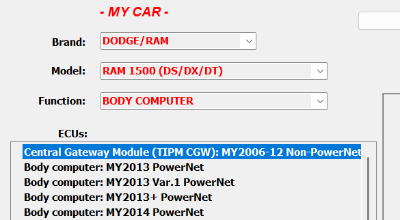

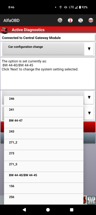

Can you detail where and how you found the 44-40/44-45 with Alfa, because when I go into the 2012 tipm/body computer, the options are all for the 243, 246, etc.
I'm lookng here:
Then here:
I went to car configuration change, tcase type, and then it was there in the list. Since I'm using an android (vs. windows), I wonder if that is why they are showing different?

Your connecting to the same 2006-2012 non-powernet TIPM CGW, like the highlighted selection on my first image above, post "22? Not under MY2013, or something else?
The reason I ask, is that the bottom drop-down, at the very bottom, (select control unit), has an option for "body computer too".

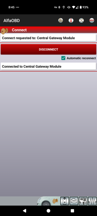

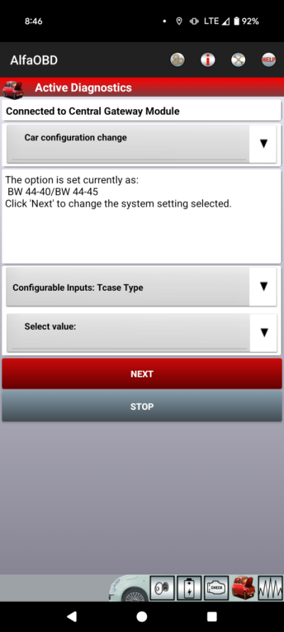

Not sure exactly what to say...here's the screens from start to transfer case selection....
TIPM CGW (2006-2012 Non-powernet), Car Configuration Change, tcase inputs, BW 44-40/44-45...
Also is the list of choices I have.
Perhaps it is a version difference?
Yea, that's very interesting.
It could also be that I don't have a 2012 to actually connect to.
The options might change when actually connected, rather than just browsing options without a connection.

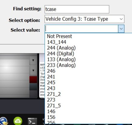

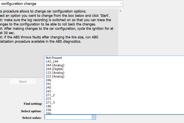

When I select MY2006-2012 on the start page of AlfaOBD, I have 5 more options under tcase type.
Also, on mine, it shows all numeric designations, no BWxx-xx.

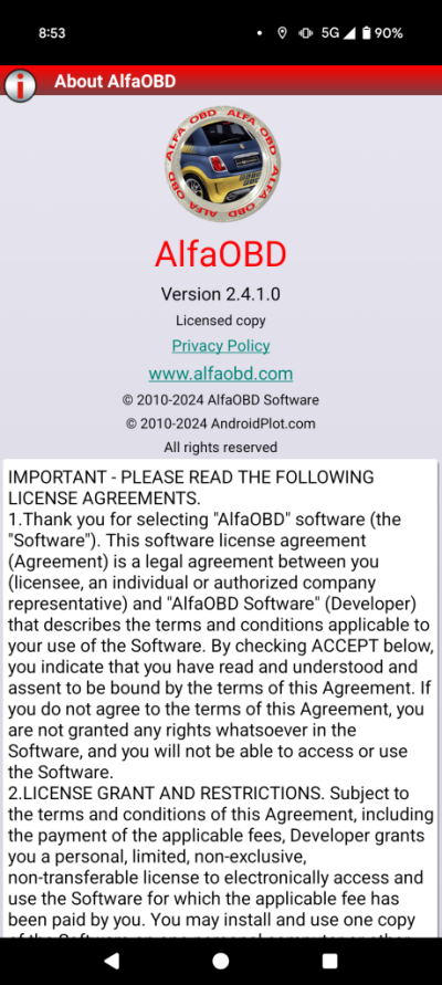

That's the same thing I have.
He's on 2.4.10, while we are on the current version, 2.5.5.0, so that could very well be the reason too.
But, i think the 246 is pretty much the same case as the 44-44, and the 243 is the same as the 44-45, so those two options should (maybe) work for the 44-44 and 44-45.
I had the same thought but after reviewing the changelog data for 2.4.1.0 for android and 2.5.5.0 for windoze, they both have a last update as 11/2024.
Both versions appear to be the most current for the respective platforms.
This could be another AlfaOBD mystery. :cool:
