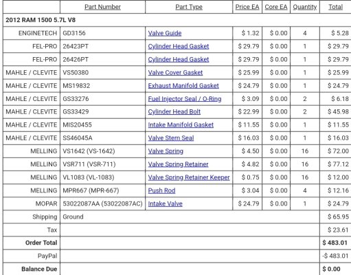

Need to find a full set of valve springs and push rods, a single intake valve and guide, locks and retainers as well as a valve cover and gasket set, head, intake and exhaust gaskets.
Anyone know of a solid place to source OEM spec stuff? All I'm finding is springs for upgraded cams, or "OEM" stuff from sites I have never heard of/trust.

Parts ordered to fix the truck. If I missed anything please let me know. I've been totally frazzled the last couple weeks dealing with all my vehicles basically breaking down.l1000002643.jpg

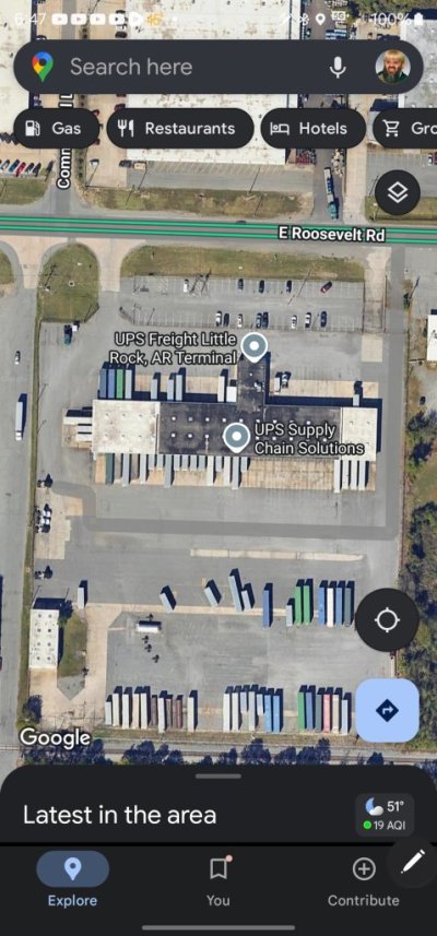

I am FUMING right now. My A/C condenser shipped with UPS and you'll never fawking guess what happened. They lost the fawking thing. In this terminal of all places. I worked retail distribution out of building bigger than this and was able to locate lost product in less than an hour. How TF you lose a giant pizza box in a wide A** open building the size of an IHOP?!?!
