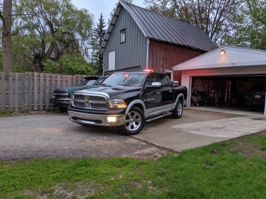

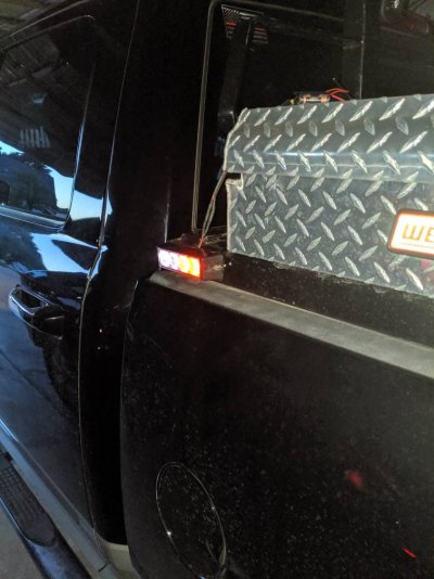

I got the truck at close on a Wednesday night. Thursday I worked a 16 hour day. Friday was decently short and I wasted no time digging into this truck. I yanked the folding bed cover off, plulled all the lights and siren out of my green truck, mounted the back rack and toolbox, and got to work ripping into the interior. I pulled the back seat and all lower trim panels and rolled the carpet back to tuck the wires away. I ran them through the rear cab vent (god those things are a blessing to have for this kinda stuff). Sadly I had to drill two holes to mount my controller.
For anyone who likes this kinda stuff here's my list of equipment.
Feniex 4200 mini
Feniex Storm Pro 100
Feniex Triton 100
Sho-Me red LED/ white Strobe mini bar
Star signal mini phantoms (2 r/w, 1 r/r)
Code 3 t4 surface mounts (2 r/w not yet mounted, not sure where to go with them just yet, have a couple ideas)
The pods are Type S Bluetooth controlled (I know, I know, AutoZone yikes.) They actually perform very well. They were a impulse buy that truly impressed me and have turned out much better than I was expecting them to. The quality exceeded my expectations, and they are functional and very reliable. I was hoping to be let down so I could return them but they've actually been a very good purchase. They're extremely effective as warning lights and as a work light, and they are built very well. It'll be a couple years with them and no lens fade or moisture intrusion.

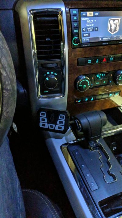

I mounted the 4200 mini controller to the center console top. The storm pro behind the panel under the steering wheel, I have a distribution block under the column mounted to the big aluminum bracket that conveniently had two deep holes I was able to tap threads into and use a bolt to secure my distribution block and the relay for it. The wiring under the column is kind of a mess at the moment but I ran out of time this weekend and had everything in the right area so I hooked it all up. I'll clean it all up in the next week or two and get things tidy like I want. This took until 3am Saturday morning and most of Saturday afternoon/night. Everything went smoothly, I just am very picky about how I orient things. The Triton is mounted to the a/c condenser bracket on the right side. I had to drill new holes in the Feniex bracket to move the speaker back so it would clear the grille but not too far or it would hit the condenser. I moved it twice. My first try cleared the grille completely but hit the condenser so I had to give it another go. 2nd try got it perfect.
While I was waiting for some stuff to dry after painting, I also LED swapped the dome lights up front and the one in back. I also tracked the intermittent fog light in/op down to a yellow heat shrink butt connector that was never heat shrunk, and the doofus used the wrong crimpers and punctured the insulation. I'll fix that after work Monday.
I have videos of some of the adventures but for the most part anyone who has this stuff, already knows how to do it and anyone who doesn't have it, probably doesn't care. So here's a couple pics and a video of the finished product.f12c8f0a72e1108dbd98e9affe2cad5e.jpg9ef8830f56f2b769a2ed786519e7dc6c.jpg6cc18676fffd9be51cf9873fdb5a29f4.jpgabcd66f63986d3d1b3877db207ff2ffc.jpg2e8d49ecbc5789abc8be0e8838f5c56d.jpg

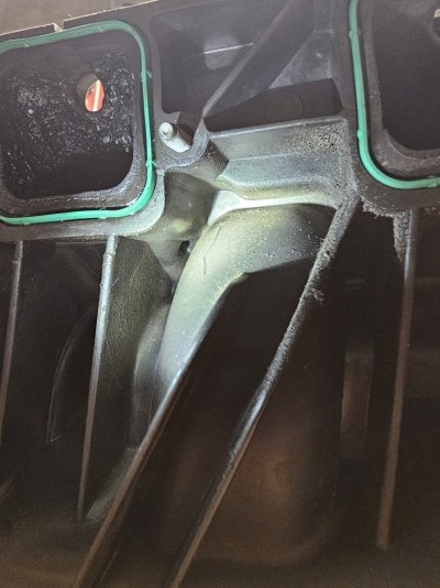

Good news. Dropped by the Ram dealer today. Found an open recall for the fuel tank bracket. Got that scheduled. Also gonna have the Bluetooth updated as it was still running the old 2.110 software (hoping this allows me to connect my phone to the radio)
I did so e hunting for info on the ITBM and I can get one from another dealer about an hour away most likely. If I can do that soon, I should be able to have the truck reflashed while it's in for recall and the radio update.

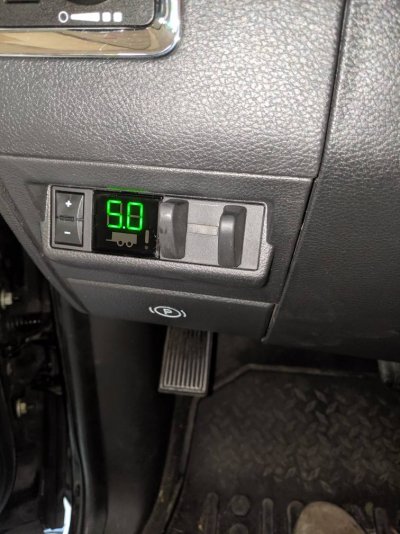

Alright so after a couple issues, I ended up having to go to a different dealer. This one was an hour and a half away. I made it a half hour before they closed up for the day. And I have to call back Monday to get a PIN for the controller activation. Noted on the directions, didn't realize it until I got home. Other than that, I should be ready to rock for memorial weekend.

Mounted and plugged in. Gotta get it to the dealer for the sway control I think but the screen lights up and it does the initial key on self check.

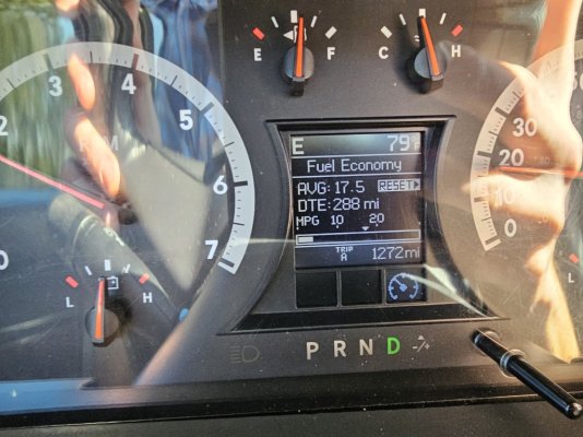

Also averaged nearly 17mpg today at 80mph on the trip to go get this thing and back. Not bad. I think I could squeeze 20 out of it if I grannied it. 01bd55b43e1dac2355e2e1e72761617c.jpgc82b1f7b2b3b54329d1c66a5a8041fb5.jpg

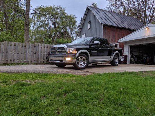

Traded taillights today! Looking like a civilized truck now! Also tested the 4x4 out a bit tugging a tree around that got knocked down in a storm yesterday. Wasn't much work for the truck. I was flipping the tree around myself but I'm lazy and using the truck was more fun. It was dead as all hell. Had been for years. The roots were even dry and snapped off underground. e2ca2c0e44cecaac97e661b343c981c4.jpgaddbfce8ddc1efdbec355377dc3775b3.jpgd4c9cbdaa19cdf24e60d9b5201d4b6be.jpg79483fc1804a744330de401ea4f7fd08.jpg

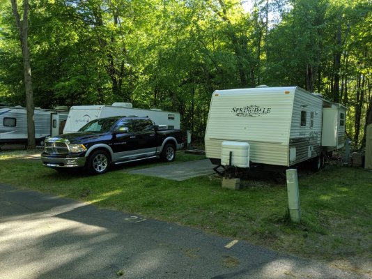

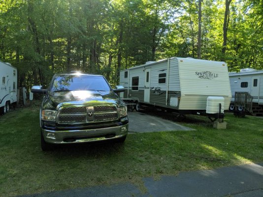

Got the camper hauled out and set up. This truck tows so unbelievably well. Even with 30mph cross wind gusts, the truck felt very stable. Enough so that I was perfectly confident towing at 70-80mph. I drive semi for a living so towing for me is something I'm very familiar with and have developed a very finely tuned sense of my comfort zone is.
With 20psi in the in-coil bags, the truck sat level, the trailer sat level, the mirrors allowed great visibility, and the ITBM functioned flawlessly. The steeper inclines slowed me down at highway speeds, but I want expecting 6.7 Cummins performance to begin with. It's a half ton with a six speed auto.

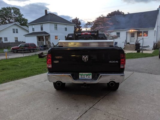

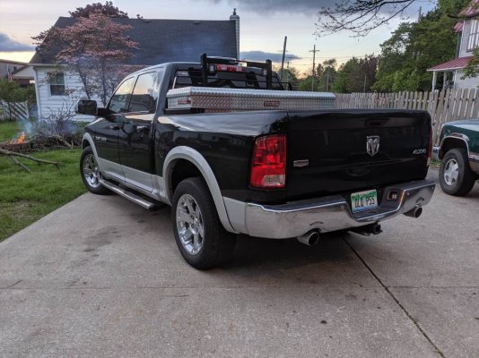

Pic time!393cdac36bb13fe483cbb717f92b8b10.jpg5ad9f170d6734a8c6ab4b30b24043fce.jpg8f3a01f1cd3a2f45ce0e4721d4e776a7.jpg

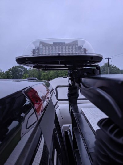

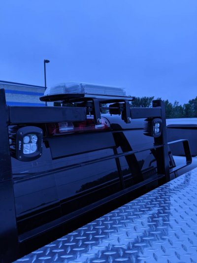

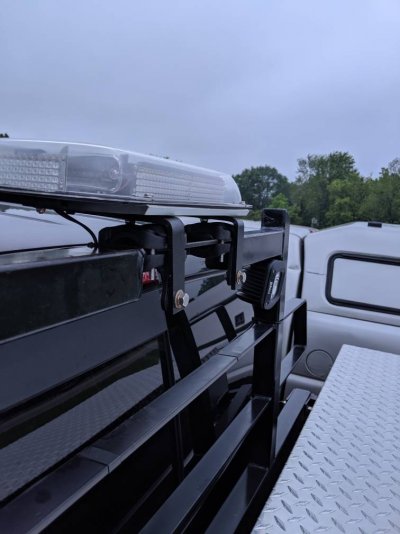

I did manage to build some brackets for my mini light bar and mounted it to the headache rack so it's no longer magnet mounted to the roof. So much more professional. Also built some sturdier brackets for my surface mounts and got them mounted and wired, while.i was under the column I cleaned up some.of my wiring mess and ******* some temporary grounds to a permanent location. Emergency lighting situation is right where I want it to be now. No plans to add anything else. Just upgrade stuff as things get old.
Next up will be the pre-load spacers. Then I'm ordering adapters to get my nice wheels on this thing. bb055d367e2bd1f4b8e5181f0c8b14bd.jpgec6dcb0605300209f09aafeb75989e75.jpgbd1c4c4da307d6a3fb21c510e6b671b8.jpgd45594f4f29c6c3bf35434fa934f50cc.jpg66f5e7a179f56937a5e56614d94d50e7.jpg

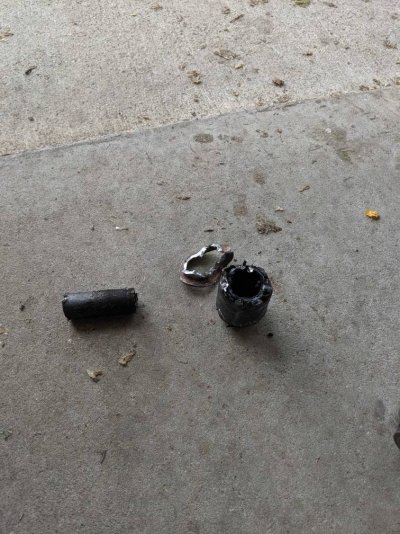

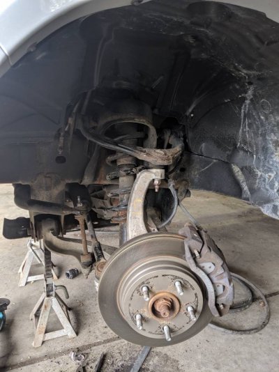

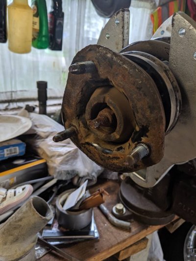

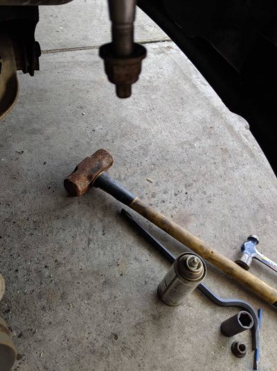

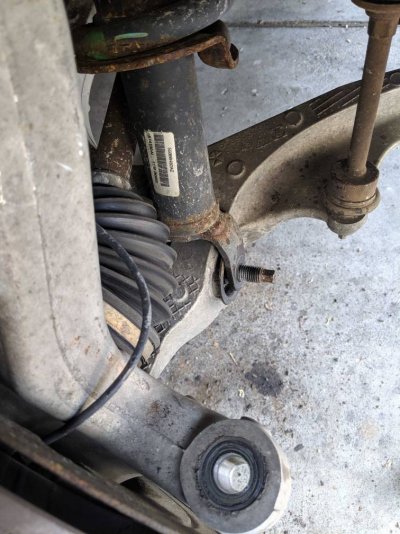

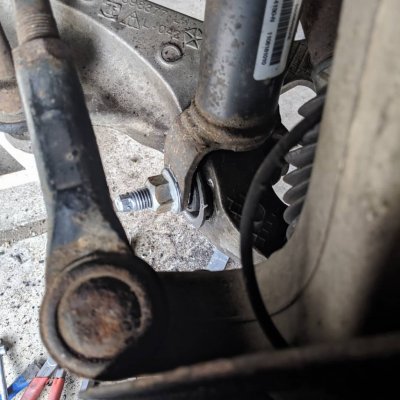

So, coil spacers will not be going on my truck. Over the course of the past two days this thing has fought me tooth and nail eventually resulting in both struts absolutely refusing to come apart. Guess the RC kit will end up in the classifieds and go towards bils and new coils. Nothing like desperately needing tires, having a set of brand new ones laying in the garage and having one more delay in being able to use them......I fought this one to the bitter end. But my current struts have refused to come apart. Leaving me with one option. To get all new stuff. 6cfa033e099c98c7f5477c6284d12af5.jpg818a03a153cb810175b4baf979965978.jpge6b612f8efdc4566ed42dcff6136c43c.jpg94c34aed039d27ac9ac9e0d3cfa0ef35.jpg8ba76ed0859345abacc4f3d7ada59a40.jpg50f9725d4c289faa6cbe2ccdb7ab6c9f.jpg

What seems to be keeping them from separating?
Might need a bigger BFH????
- The Blue Mule
G-Ride990
Administrator
Administrator
Jul 17, 2017
2,668
3,838
Chandler, AZ
Are you just having trouble getting the struts apart now?
Even on my truck with about 13k miles in rust-free Arizona, I had to cut one of the struts apart with a body saw. They can just be a pain in the ass sometimes I guess.
Yeah the struts refuse to come apart. That top nut will not break loose. So I'm left to buy bilsteins right out of the gate. Which I probably should have done from the start instead of trying to go cheap.
