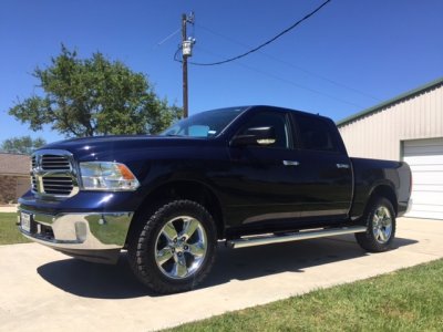

thought i would update this thread. i removed all the badges i could and had it detailed. all the stains came out and looks good. still waiting on the dealer to get the parts in for the cowling on the windshield, they are covered under warranty which is good.
Luke
