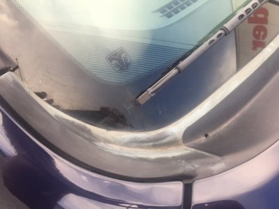

But now i am waiting for the other reason i took it into the dealer. my windshield cowl pieces are coming apart. you can rub your finger on them and the rubber comes off and it degrading. i think these should be covered for sure. the pics are below.
