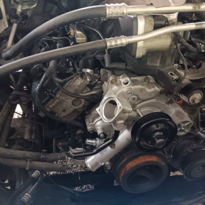

So long story short replaced cam / lifters timing chain water pump...other few items...to get rid of lifter tik. Cam lobe on cyl 3 was worn down very bad. Forgot to torque the cam bo;t so it spun and bent some valves / pushrods.
Tore it back down. Took heads to a great machine shop. they rworked everything. Did a great job. Put it all back togather. Cranked right up. Ran very well. Got it up to temprature and started hearing a missfire. Got continually worse. Got misfire on cyl 3 along with random missfires. Checked compression. 0 compression on #s 1 and 3 cylinders.
Removed driverside head. Looked great. Pistons lookes good. No crosshatch in any cylinder but no ridge at to to speak of. Re installed head without pushrods and lifters and rechecked compression.
No compression. poured in some Lucas oil and retested. Compression jumped right up, so looks like the rings got blown out maybe due to the heads being reworked with some new valves and all other rseated along with valve guides knerled except two that were rplaced.
so we're gonna remove the pistons out the top and rering, hone enough to take off the glaze being extra careful to keep everything clean.
Anyone pulled the pistons out the top with the engine in the truck? Got a set of clevite rodbearins and mahale rings arriving by tonight.

It'd down to the bare block right now. We're ready for the rings and bearings to do 1 piston at a time. So the pic's above are while we were working on it.
