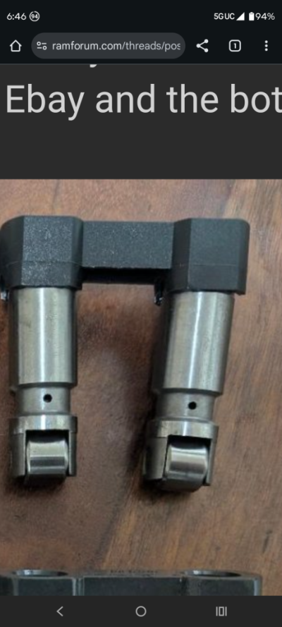

Just joined up so I could pick some brains. I did a cam and lifters on a 2014 5.7. Did my best to purchase quality parts but think I got counterfeit lifters from Ebay. Quick rundown of events. Got the truck with cylinder 3 misfire, only felt it in gear, at idle it was smooth and quiet. Tore apart and cylinder 3 intake lobe and lifter wiped out. Checked solenoid screen and clean, so decided to do cam and lifters. Bought Melling OEM grind cam, and supposed OEM lifters. Reassembled engine and all seemed good a bit noisy from top end, but hoped it just needed a little time. After reaching EOT in park, misfire 3 returned, but only now in park, in gear goes away, put in park and raise a idle a bit, goes away. This is opposite of original misfire fault. Compression is perfect. Valvetrain noisy. I certainly believe that the lifters are fake. I bought 1 set of OEM lifters from Rock Auto just to compare with the ones from Ebay and what I see is the ones from Rock have a laser etched number on the collar and no oil hole in the collar area like the Ebay and the roller pin looks like a different metal as the color is different. I would like to hear from other members on what OEM lifters should be like compared to fakes. Did the OEMS come in different styles or variations. What have your OEM lifters looked like? The top set in photo is Ebay and the bottom set is from Rock. Thanks thumbnail (1).jpg

100% fake
No OEM Hemi lifters have these oil holes.
There are only 2 "styles", of eom hemi lifter, mds and non-mds.
The lifter pictured is 100%, for sure, not a Mopar lifter. Neither mds nor non-mds. It does however look exactly like one of those Chinese lifters sold under names like Sealed power, DND, RookSame UbuyNow, etc.
The one from Rock Auto sounds like OEM. The lack of oil hole and the laser etching are correct.

Here's a front set of OE lifters. I dont have a pic of the rear set, but they are exactly opposite of these.
Your pic of the RockAuto lifters looks like a rear set, and looks good. You can see differences in the finish quality between the OE and Ebay ones.

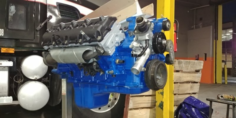

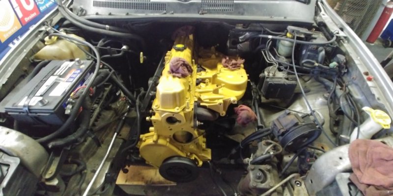

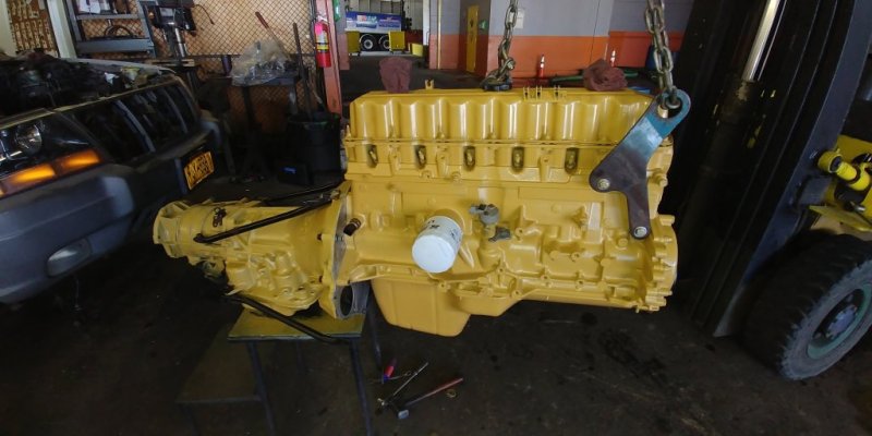

Sorry to say but this motor is not getting painted, was laid up too long so being assembled and dropped in and kicked out the door. Not my truck but an employees truck over here. I will share some pics of the Ram Hemi I did for my friend back in 2022 and the Jeep 4.0 I did for my son. The Jeep motor was painted Caterpillar Yellow. Looked really cool and my son got a lot of remarks from oil change centers when he had it down in school. This was back in 2020, truck still driving up and down the east coast.
