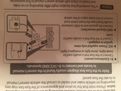

Decided to install a dash cam after my trucks been hit a few times at the train station where I leave it every day. I'm having problems hard wiring it. The kit instructs you to locate a constant power fuse and an accessory fuse and wrap the corresponding wires around the leg of each fuse and reinstall the fuse. I chose the fuse marked cigar lighter as the accessory and the fuse marked trailer brake/flash as the constant. Both of which are 20A and happen to be next to each other. The camera does not turn on. Anybody have any ideas of which fuses would be best to tap into? I originally thought the power ports on the dash would be perfect. The USB port on the right of the dash stays live when the trucks off. The cigarette lighter style accessory port on the left dies when the trucks off. But I can't identify them by the descriptions in the fuse panel.

I grounded it to the ground bolt Under the hood. I thought the engine compartment fuse box was the only one. The camera is a thinkware f750 which is a pretty popular system. I don't know much about wiring but that's what the instructions say. I'll try a different fuse and see what happens. I thought a break light would have constant power but not sure about the trailer brake connector.

The add a circuits looks like a cleaner way to do it. I'll pick up a couple. Thanks. Just gotta figure out where to tie into. Would it be ok to attatch the constant directly to the battery? It's a thin wire with its own fuse attached to it. The camera has a battery monitor in it so it doesn't over drain the battery.

If it's a fused lead then put a ring terminal on the end and attach it to the accessories post of the under hood fuse block.

That did the trick. I tied one wire to the post with the terminal and the other to the auxiliary port fuse. Thanks for the help.
