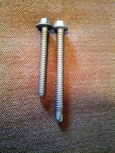

I actually did just that. Its slightly longer but not by much. It threaded and tightened. I still get a whistle but I think that's normal now. I sprayed carb cleaner around the TB and the idle didn't change which I assume it would have otherwise. I may have a small leak around the hose. But I can deal with that.

If I remember I'll get some pictures of the bolt I used next to the stock bolt.

Man Sorry for the my need it..... so i have the same problema in my 4 hole Intake, curiusly my Throttle body is really hard, whit my 2 hands i did can move or feel it bad, but.... the 4 bolts are loose, not like to move whit my hand, but loose for the tool....
i hope understand me..... i´ll like to see the bolt than you used in your truck, or the bolt especifications...!!!

Hey, sorry for the late response, been away from the site the last few weeks. I'll go digging to find the bolt. Basically the bolt just needs to be a little wider, the thread was also a little more aggressive.
Edit: here's the bolt on the right, stock bolt on the left. Don't know the actual dimensions, I just went to a fastener shop and have them the stock bolt and they found that one to match. Just grind off the bottom.

are you frickin kidding me? THOSE are the kind of bolts mopar uses for the throttle body?? why the heck not a regular fine thread bolt? the intakes SHOULD have been designed with a metal threaded insert for a metric treaded bolt. imo...

Yeah, it's pretty irritating how easy it is to strip the hole. I can't believe they thought it was a good design.
