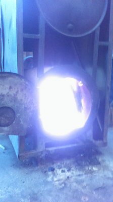

I happen to have five 5G cans of gas, two 5G cans of diesel, two 5G pails of diesel, several 5G pails of used oil, Plenty jugs and pails of good oil around here right now.
Used oil and diesel is good in the garage furnace for them cold winters.
