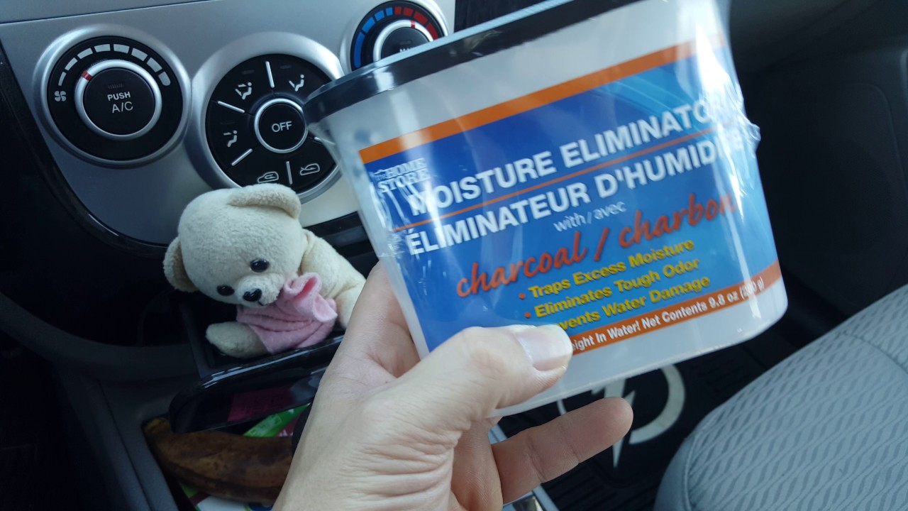

Dollar Tree sells dehumidifiers for a buck. I put one in my truck because the windows were always wet after sitting out in the cold and rain for a few days. Cleared everything up including lingering odors. Might be worth checking out.

You don't have a picture of these dollar tree dehumidifiers, do you?
Check out Turkeybird's post-he included a link. Of course the guy in the video is showing a totally used one haha. They work, trust me. I put them where ever I don't want damp IE; gun safe, etc.
