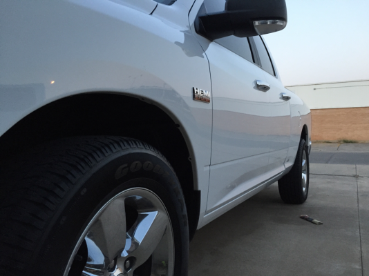

My truck has been filthy because of how busy I am with work. So I decided to give it a wash.
Which lead to a clay bar, sealant, Colinite and VRP.
I have to say, I think this Chemical Guys V.R.P. is one of my new favorite products. The smell is amazing and it looks great.

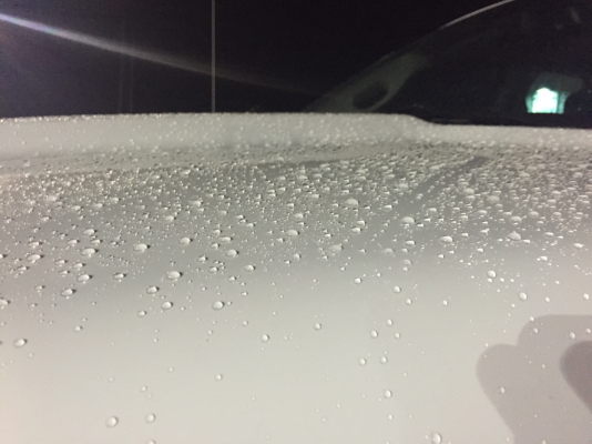

Is it bad, I'm still not entirely happy with the beads?
